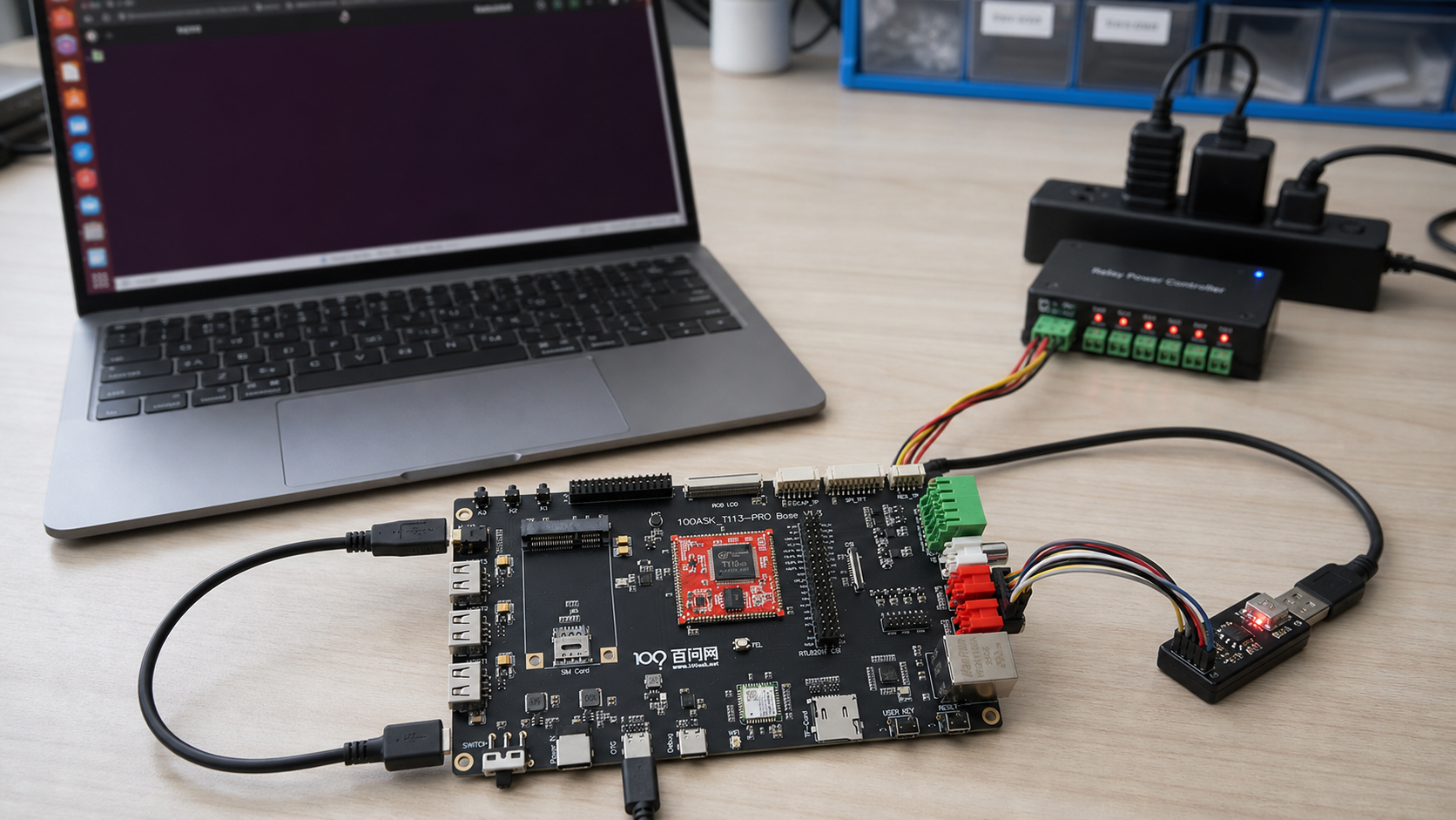

记录四:本地门禁通过,但硬件 installer 没启动
干净仓库重建后,语法、格式、哈希、FIT、UBI 和地址门禁全部通过,但真实硬件任务得到:
"taskId": "mainline-1787708850567538011",
"status": "failed",
"phase": "waiting_for_installer",
"progressPct": 50.0,
"error": "MAINLINE_INSTALLER_TIMEOUT:no completion marker within 180 seconds",
"classification": "failed-do-not-use",
"artifactManifest": "manifests/clean-build-20260825.sha256"
根因最终定位到 U-Boot 永久补丁 hunk 计数错误:补丁声明新增 15 行,实际包含 16 行,末尾 CONFIG_CONS_INDEX=4 没有进入干净构建。板卡实际使用 UART3,而构建结果回到了 UART0,因此 installer 是否运行无法被预期串口观测和验收。
提交 d1eedf7 修正 patch hunk,并新增两个门禁:
- 检查永久补丁中保留
CONFIG_CONS_INDEX=4; - 检查最终构建配置确实使用 UART3。
这次失败说明:make all 成功和本地 fail=0 都不是上板成功。
记录五:硬件基线复验
选择已知硬件验证 bundle 的确切 SHA-256 后,Lynx 任务得到:
"taskId": "mainline-1787709324680503509",
"status": "success",
"phase": "complete",
"progressPct": 100.0,
"exitCode": 0,
"classification": "verified",
"artifactManifest": "manifests/verified-hardware-artifacts.sha256"
随后 Lynx Power 对设备 5、继电器通道 6 执行两秒断电:
{"deviceId":5,"action":"power_off","status":"success","relayChannel":6}
{"deviceId":5,"action":"power_on","status":"success","relayChannel":6}
复验排除了板卡损坏、FEL 工作流整体失效等可能性,把问题重新收敛到 clean build 的源码/补丁差异。
记录六:源码重建产物最终通过
修复永久补丁并重新构建后,脱敏证据记录了完整闭环:
{"event":"installer_task","taskId":"mainline-1787715829104265529","status":"success","phase":"complete","progressPct":100.0,"exitCode":0}
{"event":"installer_evidence","markers":["LYNX_PROGRESS phase=installer_complete progress=100","MAINLINE INSTALL COMPLETE","Trying to boot from sunxi SPI","VFS: Mounted root (ubifs filesystem)","t113s3pro-mainline login:"],"result":"warm-reboot-pass"}
{"event":"power","controller":"lynx_power","deviceId":5,"channel":6,"action":"power_off","status":"success"}
{"event":"power","controller":"lynx_power","deviceId":5,"channel":6,"action":"power_on","status":"success","offIntervalSeconds":3}
{"event":"cold_boot_evidence","markers":["UBIFS: mounted UBI device 0, volume 0, name rootfs","VFS: Mounted root (ubifs filesystem) on device 0:15","t113s3pro-mainline login:"],"result":"cold-boot-pass"}
第二轮断电间隔为两秒,也再次到达登录提示。由此,manifests/hardware-verified-source-rebuild-20260825.sha256 对应的产物才被晋升为 hardware-verified。
